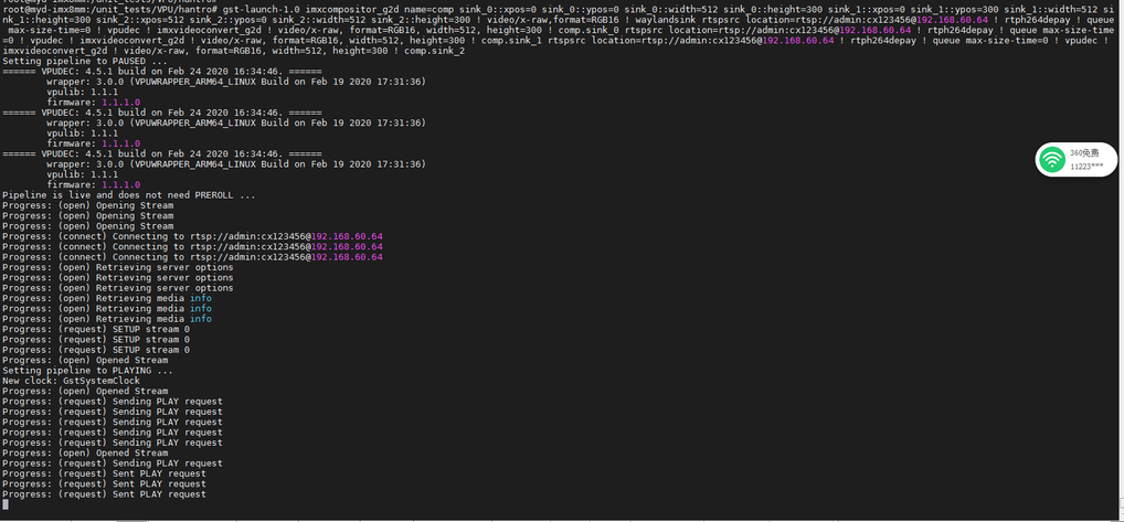

I found the following way to achieve it, but it can only display videos from three IP Camera at most,
The instructions for displaying three IP camera videos normally are as follows(it ok):
gst-launch-1.0 imxcompositor_g2d name=comp sink_0::xpos=0 sink_0::ypos=0 sink_0::width=512 sink_0::height=300 sink_1::xpos=0 sink_1::ypos=300 sink_1::width=512 sink_1::height=300 sink_2::xpos=512 sink_2::ypos=0 sink_2::width=512 sink_2::height=300 ! video/x-raw,format=RGB16 ! waylandsink rtspsrc location=rtsp://admin:cx123456@192.168.60.64 ! rtph264depay ! queue max-size-time=0 ! vpudec ! imxvideoconvert_g2d ! video/x-raw, format=RGB16, width=512, height=300 ! comp.sink_0 rtspsrc location=rtsp://admin:cx123456@192.168.60.64 ! rtph264depay ! queue max-size-time=0 ! vpudec ! imxvideoconvert_g2d ! video/x-raw, format=RGB16, width=512, height=300 ! comp.sink_1 rtspsrc location=rtsp://admin:cx123456@192.168.60.64 ! rtph264depay ! queue max-size-time=0 ! vpudec ! imxvideoconvert_g2d ! video/x-raw, format=RGB16, width=512, height=300 ! comp.sink_2

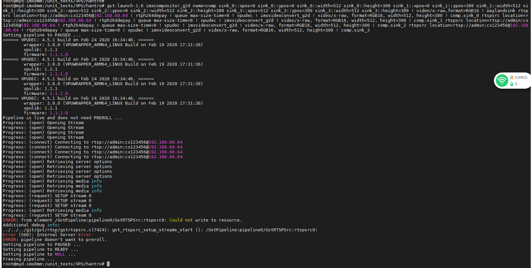

But when I use the command to display 4 IP camera videos, an error occurs, as shown below. What is the reason?
gst-launch-1.0 imxcompositor_g2d name=comp sink_0::xpos=0 sink_0::ypos=0 sink_0::width=512 sink_0::height=300 sink_1::xpos=0 sink_1::ypos=300 sink_1::width=512 sink_1::height=300 sink_2::xpos=512 sink_2::ypos=0 sink_2::width=512 sink_2::height=300 sink_3::xpos=512 sink_3::ypos=300 sink_3::width=512 sink_3::height=300 ! video/x-raw,format=RGB16 ! waylandsink rtspsrc location=rtsp://admin:cx123456@192.168.60.64 ! rtph264depay ! queue max-size-time=0 ! vpudec ! imxvideoconvert_g2d ! video/x-raw, format=RGB16, width=512, height=300 ! comp.sink_0 rtspsrc location=rtsp://admin:cx123456@192.168.60.64 ! rtph264depay ! queue max-size-time=0 ! vpudec ! imxvideoconvert_g2d ! video/x-raw, format=RGB16, width=512, height=300 ! comp.sink_1 rtspsrc location=rtsp://admin:cx123456@192.168.60.64 ! rtph264depay ! queue max-size-time=0 ! vpudec ! imxvideoconvert_g2d ! video/x-raw, format=RGB16, width=512, height=300 ! comp.sink_2 rtspsrc location=rtsp://admin:cx123456@192.168.60.64 ! rtph264depay ! queue max-size-time=0 ! vpudec ! imxvideoconvert_g2d ! video/x-raw, format=RGB16, width=512, height=300 ! comp.sink_3

still 8mm board, right? what video resolution do you use? how about try the lower resolution video?
1,855 Views
Liubin2
hi:
      They are all 8mm boards. The current phenomenon of playing 4 videos sometimes works normally, sometimes it doesn’t work. I tried a lower resolution and it doesn’t work. Will it be related to the IP camera?
1,847 Views
joanxie
I'm not sure if the network has issue or not? 8mm boards can support 4 rtsp video I think
