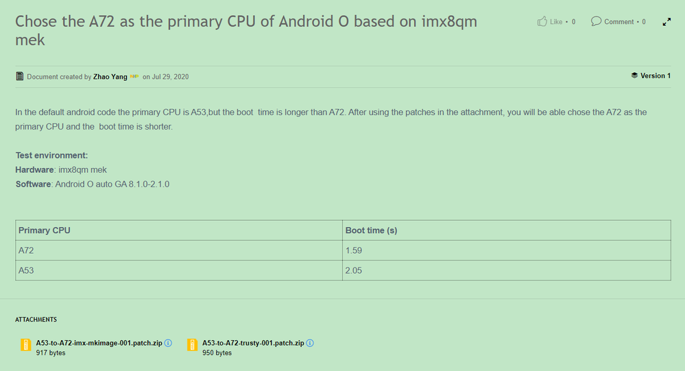

zhao_yang
hi,Yaqiang
Here is an example to change the primary CPU as A72. I hope this can give you some help.
https://community.nxp.com/docs/DOC-347300

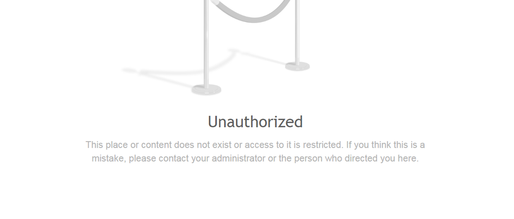

jiangyaqiang
HI Zhao:
Thanks, but I can't access the link:
2,763 Views
zhao_yang
OK, The following picture  is the detail information about the doc.
I also add the  attachments here.
