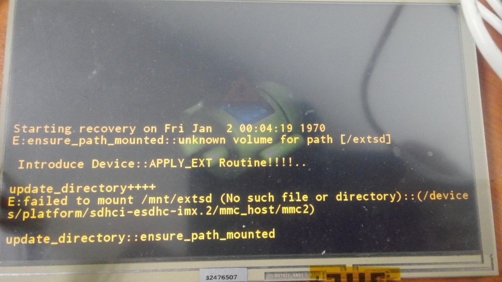

sriramperiyasam
Please replace following line
/devices/platform/sdhci-esdhc-imx.2/mmc_host/mmc1 /mnt/extsd vfat defaults voldmanaged=sdcard:auto
with
/dev/block/mmcblk1p1 /mnt/extsd vfat defaults voldmanaged=sdcard:auto
And ensure that recovery image changes flashed successfully since if you flash it using fastboot, it will not flash properly. Try to use manufacturing tool for flashing.
Thanks and Regards
Sriram.

燕频姜
Hi,Sriram
     Thank you very much!
     I have solved this problem. I used the mount("/dev/block/mmcblk1p1....") command .
     I am very grateful to you for giving me so much help。
    Yanpin

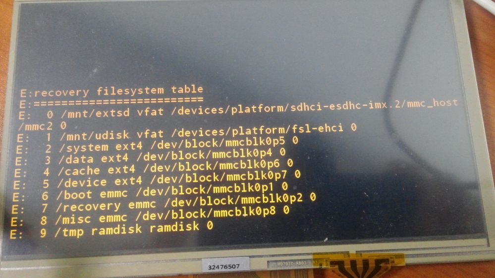

erickang
Dear Guoyin Chen,
Thanks for your response.
The SD-Card was not mounted when I applied your guide like as below
1st : ensure_path_mounted("/extsd");
2nd : ensure_path_mounted("/mnt/extsd");
I could see the below log when the board was entered the Recovery mode.
I'm using the JB4.3, and the board have SD-Card(via SD3 port) and eMMC(via SD4).
Could you tell me what's the problem?
Eric.
6,263 Views
erickang
Dear Guoyin,
I modified the below file based on your comments, and then confirmed the displayed SD-Card menu in UI menu.
common/recovery/recovery_ui.cpp
But I couldn't update the Android Image because the board couldn't mount sd-card in /mnt/extsd and /sdcard.
and I could confirm the sd-card mounting point in the below files.
1) myandroid/out/target/product/sabresd_6dq/recovery/root/fstab.freescale
2) myandroid/bootable/recovery/recovery.cpp
   static const char *SDCARD_ROOT = "/sdcard";
Could you tell me how to update the Android image on the board with SD-Card for detailed?
