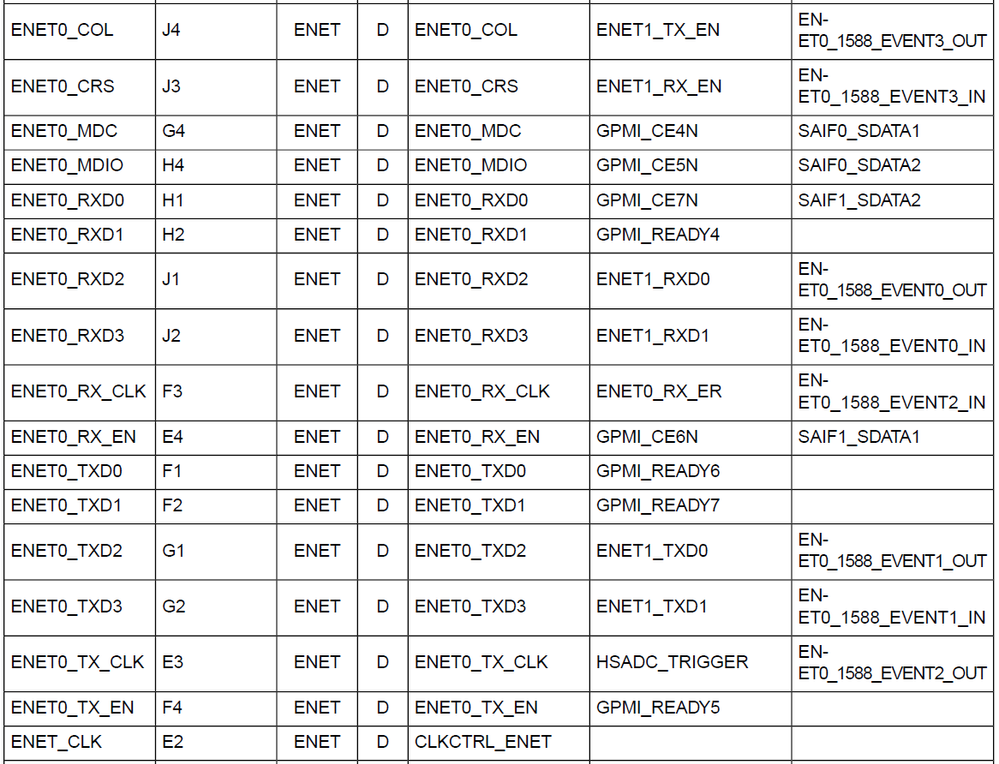

Hello,Sergii,
    The following is Mapping of MII signals, and attachment is schematic of a MII PHY named  LAN8700. you can refter to them.
regards,
Weidong
