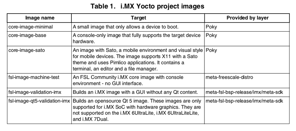

Hi M C ,
Can you let us know which of the following yocto image are you building?
Also, with the current image, use this bootargs for display 'video=mxcfb0:dev=hdmi,1920x1080M@60,if=RGB24' and then on console try playing a video with application like gstreamer? If this too doesn't work do export DISPLAY=:0 and try again.
Ankit Patel
3,449 Views
mc2017
I am using "bitbake fsl-image-qt5-validation-imx" to build images
