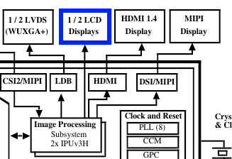

I checked out the file you mentioned but am a bit skeptical if its what I'm looking for. Here is how the display looks like from the iMX6 (image taken from page 209 of processor reference manual),
On the sabresd reference board we have a touch-screen display connected on the LDB bridge via the LVDS connection. But what I want to do is use the LCD interface directly - without configuring anything on the bridges. I've highlighted (in blue) the relevant section above. Scanning the source code in (drivers/video/mxc/ldb.c), it appears that a lot of configuration/initialization is done for the LDB bridge - are you sure this is the file I'm looking for? Or should I search elsewhere?
