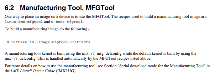

     Thanks again for your message. The problem remains that neither  here Freescale_Yocto_Project_User's_Guide.pdf       is explained how do I checkout and where from the mfg support layer. Just briefly discusses how to build it.
    So what git repository exactly I need to fetch in order to be able to run successfully:
bitbake fsl-image-mfgtool-initramfs
     I have browsed linux-imx - i.MX Linux kernel  but could not find anything related to MFG. I f I download the MFGTool from NXP page it contains only Windows executables and scripts. NO MFG specific BSP image.
    So where do I get the MFG imx6 BSP image from ?
    The documentation provided by you does not cover this and I could not figure it out from other sources or topics opened on this forum.
    Your detailed answer would be appreciated.

igorpadykov
Hi Mihaita
phytec bsps may not support it.
Please use nxp bsps described below

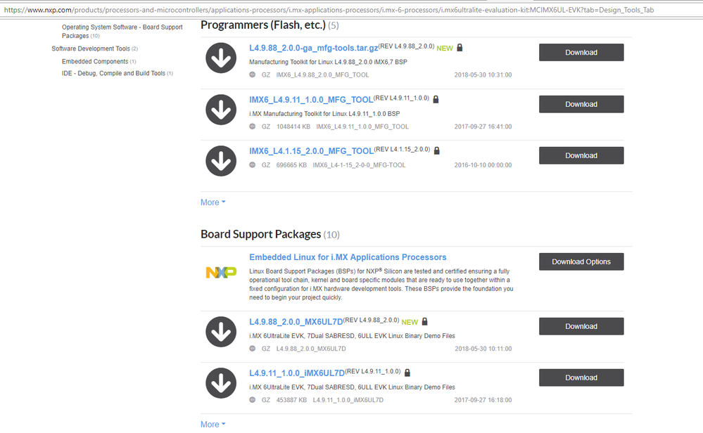

mihaitaivascu
Hi Igor,
   Thanks for your answer.
    At this link https://community.nxp.com/external-link.jspa?url=https%3A%2F%2Fwww.nxp.com%2Fsupport%2Fdeveloper-res...
there are the MFGtool binaries and imx6ul BSP pre-built images(but not one has support for MFGtool).
 There is no pre-built image, any User guide on how to enable or add support for MFGTool in your image).
  Please see the snapshot attached from NXP page
 All I got so far from NXP official documentation is this small reference:
    I would need to read somewhere on how to clone MFG layer from NXP and how to enable it in recipes.
    After that I can build an imx6 image with MFGtool support so I can then use successfully the MFGTool.exe binary on a Windows PC to update my board
      Mihaita Ivascu
