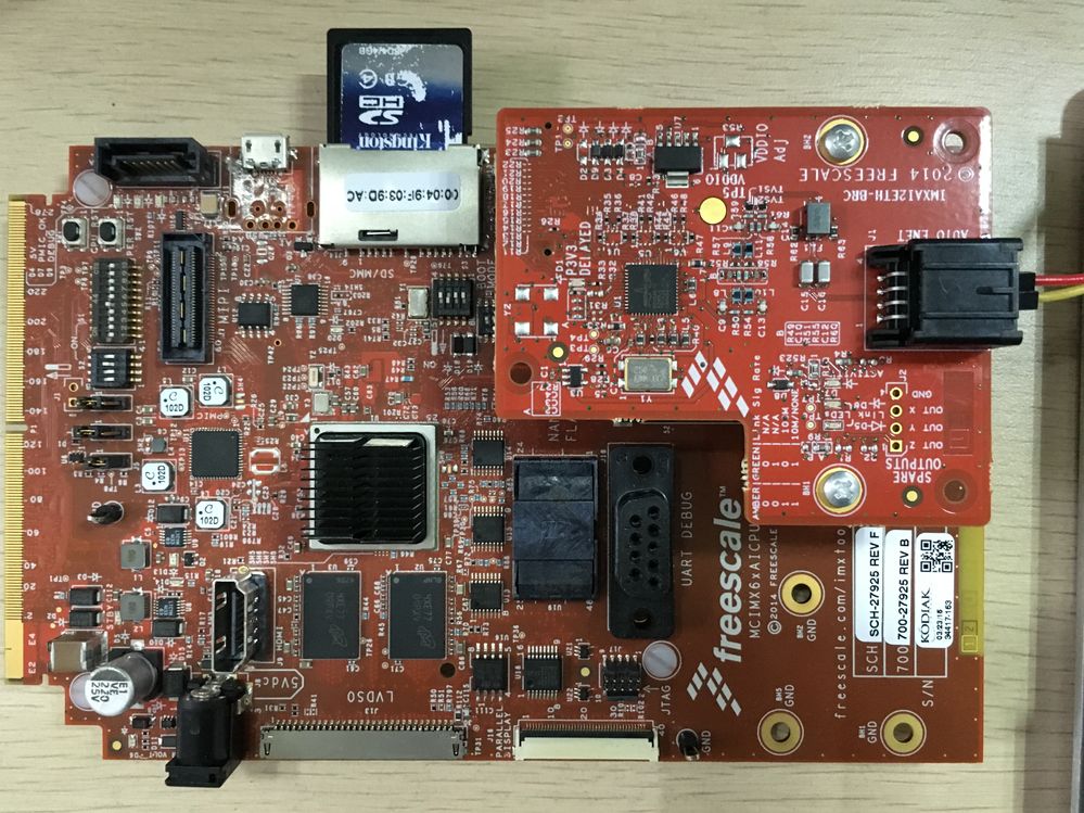

Hi,there:
     I recently bought some hardware from the NXP‘s websit - MCIMX6QAICPU2 ,IMXAI2ETH-BRC, MPC5604EKIT。Can anyone tell me how to config the Ethernet-AVB system with them? I am now have build the yocto project, but I don't what's the next steps?

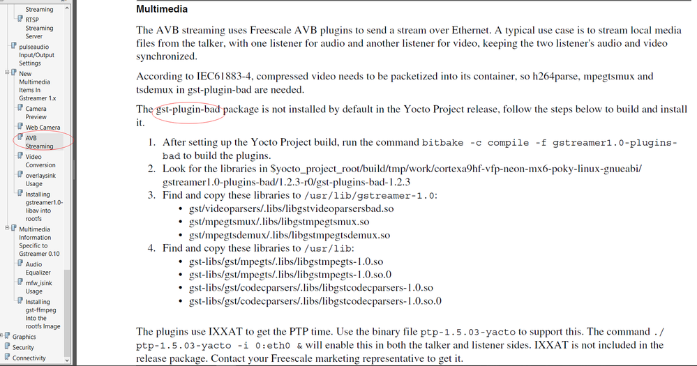

3. I have download the i.MX_Linux_User's_Guide.pdf. In 7.5.3 AVB Streaming  gives some steps as follow:
Can you tell me what is the difference between the three mentioned above? Thank you very much!
