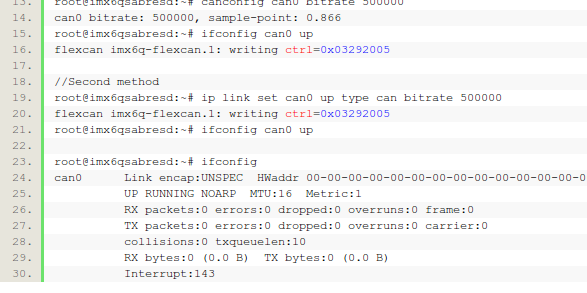

These are the commands we are used in linux through minicom.
ip link set can0 type can bitrate 125000
ip link set can0 up
cansend can0 -i 0x2a8 11 22 33
we have to finish our project quickly. help me
Thank you

ponnusamy_v
Hi all,
Finally we get data from imx6. Our mistake is we didn't press wake up button in IMX6, when pressed that button we got data from can2(10pin) port.
After that we connect CANH and CANL with MCP2551 transceiver but we didn't receive any data.
MCP2551 is connected with PIC18f458, we used same baudrate 125kbps in both IMX6 and PIC18f458.
help anyone...
Thank you...
2,658 Views
ponnusamy_v
Refer these commands and reply sir.. Thank you again...
