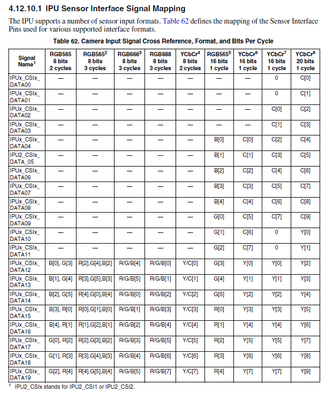

I want to change the signal mapping pins in Table 62. Camera Input Signal Cross Reference, Format, and Bits Per Cycle.
Our hardware is as follows.
So, we must use CSI0_DATA[11:4] for 8bits yuv format.
But, only CSI0_DATA[19:12] should be used in the IPU Sensor Interface Signal Mapping.
We must change the pins from CSI0_DATA[19:12] to CSI0_DATA[11:4].
What should i do?
Please help me!

pls refer to the data sheet, for yuv 8bits, connect to the high 8bits

Do you mean that it is impossible to change the pins from CSI0_DATA[19:12] to CSI0_DATA[11:4]?

yes, I think so
