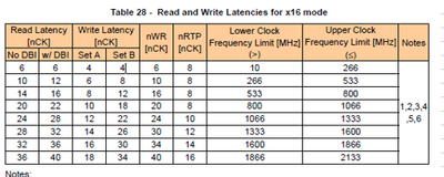

I'm using the imx93evk. The default dram configurations can be automatically generated by config tool per clock frequency selection. btw, increasing/decreasing the read/write latency is not supported by the config tool. I tried to directly change the lpddr4x_timing.c file to increase the latency. (RL 36 to 40, WL 16 to 18) The two c files are attached. TIMING_CFG_1, TIMING_CFG_2, TIMING_CFG_3, and MR2 register are modified on the new file. However, the u-boot failed with the message of "Malloc buffer failed". please let me know how to achieve this condition change.

You can follow the bwlow picture set your WL RL.
ps : We do not suggest customer modify this parameters , different value follow the different  DDR frequency and mode.

It is required to change the latency at a clock frequency for the failure analysis. Is it impossible or too complicated?
