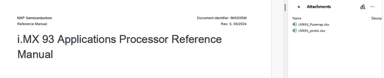

Hi @danielchen ,
          I need to go through  i.MX93_Fusemap.xlsx  can you provide me the link and procedure.
The first link which you had posted is not accessible. (https://community.nxp.com/t5/Security-Blog-NXP-Internal/How-to-fuse-key-through-nvmem-on-i-MX93/ta-p...)
672 次查看
Robbi
681 次查看
danielchen
Hi @Robbi
The fusemap is attached in the imx93 reference manual
