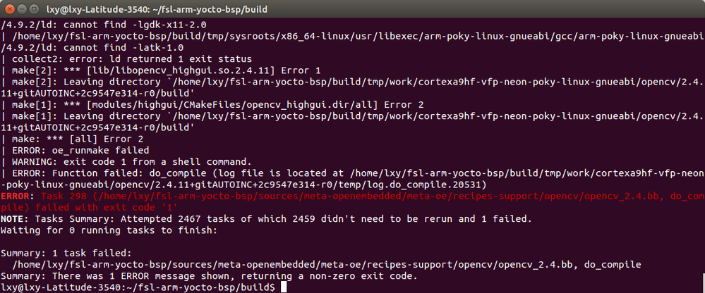

I am in the process of building a linux 3.14.52 or 3.14.28 fsl-image-qt5 image with opencv using YOCTO for i.mx6q sabre-auto,the reference and local.conf read and follow are shown below.But failed many times and need your help.

Both links you have followed should works, so please share your error log in order to find the root cause of your issue.

The detail of error looks like:
| /home/lxy/fsl-arm-yocto-bsp/build/tmp/sysroots/x86_64-linux/usr/libexec/arm-poky-linux-gnueabi/gcc/arm-poky-linux-gnueabi/4.9.2/ld: cannot find -lgtk-x11-2.0
| /home/lxy/fsl-arm-yocto-bsp/build/tmp/sysroots/x86_64-linux/usr/libexec/arm-poky-linux-gnueabi/gcc/arm-poky-linux-gnueabi/4.9.2/ld: cannot find -lgdk-x11-2.0
| /home/lxy/fsl-arm-yocto-bsp/build/tmp/sysroots/x86_64-linux/usr/libexec/arm-poky-linux-gnueabi/gcc/arm-poky-linux-gnueabi/4.9.2/ld: cannot find -latk-1.0
| collect2: error: ld returned 1 exit status
| make[2]: *** [lib/libopencv_highgui.so.2.4.11] Error 1
| make[2]: Leaving directory `/home/lxy/fsl-arm-yocto-bsp/build/tmp/work/cortexa9hf-vfp-neon-poky-linux-gnueabi/opencv/2.4.11+gitAUTOINC+2c9547e314-r0/build'
| make[1]: *** [modules/highgui/CMakeFiles/opencv_highgui.dir/all] Error 2
| make[1]: Leaving directory `/home/lxy/fsl-arm-yocto-bsp/build/tmp/work/cortexa9hf-vfp-neon-poky-linux-gnueabi/opencv/2.4.11+gitAUTOINC+2c9547e314-r0/build'
| make: *** [all] Error 2
| ERROR: oe_runmake failed
| WARNING: exit code 1 from a shell command.
| ERROR: Function failed: do_compile (log file is located at /home/lxy/fsl-arm-yocto-bsp/build/tmp/work/cortexa9hf-vfp-neon-poky-linux-gnueabi/opencv/2.4.11+gitAUTOINC+2c9547e314-r0/temp/log.do_compile.29611)
ERROR: Task 298 (/home/lxy/fsl-arm-yocto-bsp/sources/meta-openembedded/meta-oe/recipes-support/opencv/opencv_2.4.bb, do_compile) failed with exit code '1'
