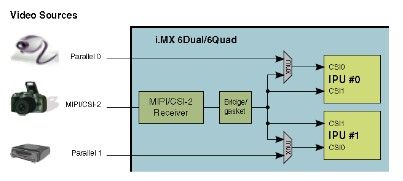

Now we meet a problem on CSI_1 interface of IPU_1. On our board CSI_1 is connected to adv7182 for video capture.
adv7182_HS and adv7182_VS signal are not used. and 8bit data port are connected as below
csi1 pixclk   [pin H25]                 ->               adv7182_pix_clk
csi1 data12 [pin G24]                ->               adv7182_data0
csi1 data13 [pin J22]                 ->               adv7182_data1
csi1 data14 [pin G25]                ->               adv7182_data2
csi1 data15 [pin H22]                ->               adv7182_data3
csi1 data16 [pin H23]                ->               adv7182_data4
csi1 data17 [pin F24]                 ->               adv7182_data5
csi1 data18 [pin J21]                  ->               adv7182_data6
csi1 data19 [pin F25]                 ->               adv7182_data7
I noticed that CSI_1 is connected to IPU_1
So I make below patch for CSI_1 interface.

jonathansperry
Hello jun,
I also have similar problem.  I am able to capture BT.656 video on IPU0/CSI0 but not on IPU1/CSI1 on sabre sd board.  I made the following modifications to board-mx6q_sabresd.c
changed:
mxc_iomux_set_gpr_register(1, 19, 1, 1);
to:
mxc_iomux_set_gpr_register(1, 20, 1, 1);
changed:
static struct fsl_mxc_capture_platform_data capture_data[] = {
  .csi = 0,
  .ipu = 0,
  .mclk_source = 0,
  .is_mipi = 0,
  .csi = 1,
  .ipu = 0,
  .mclk_source = 0,
  .is_mipi = 1,
to:
  .csi = 1,
  .ipu = 1,
  .mclk_source = 0,
  .is_mipi = 0,
  .csi = 0,
  .ipu = 1,
  .mclk_source = 0,
  .is_mipi = 1,
Setup mux pins to the following:
static iomux_v3_cfg_t mx6q_sabresd_csi1_sensor_pads[] = {
  /* IPU2 Camera */
  MX6Q_PAD_EIM_A17__IPU2_CSI1_D_12,
  MX6Q_PAD_EIM_A18__IPU2_CSI1_D_13,
  MX6Q_PAD_EIM_A19__IPU2_CSI1_D_14,
  MX6Q_PAD_EIM_A20__IPU2_CSI1_D_15,
  MX6Q_PAD_EIM_A21__IPU2_CSI1_D_16,
  MX6Q_PAD_EIM_A22__IPU2_CSI1_D_17,
  MX6Q_PAD_EIM_A23__IPU2_CSI1_D_18,
  MX6Q_PAD_EIM_A24__IPU2_CSI1_D_19,
  MX6Q_PAD_EIM_A16__IPU2_CSI1_PIXCLK,
But still can't get video captured.  If you find a solution let me know.  I will do the same for you.

junsun
hello jonathan,
Do you check the PAD select configuration? If  want to use CSI_1, we need to modify the pad select configuration (DAISY chain) for each pin .  Besides, do you check the pixel clock pin? it should output 27Mhz clock.
By the way, the reset pin and power_down pin must output high level.  Finally , i think the 8bit data pin also need to check. Because the EAV and SAV signal are very important if you not use VS and HS signal.  Hope above info could help you. If your design works, please let me know.

junsun
hello jonathan,
We are sure that CSI_1 can work now. Formely, our design can't work is rooted by the crystal not output a stable signal.  Please double check the signal quality  of your hardware design.
