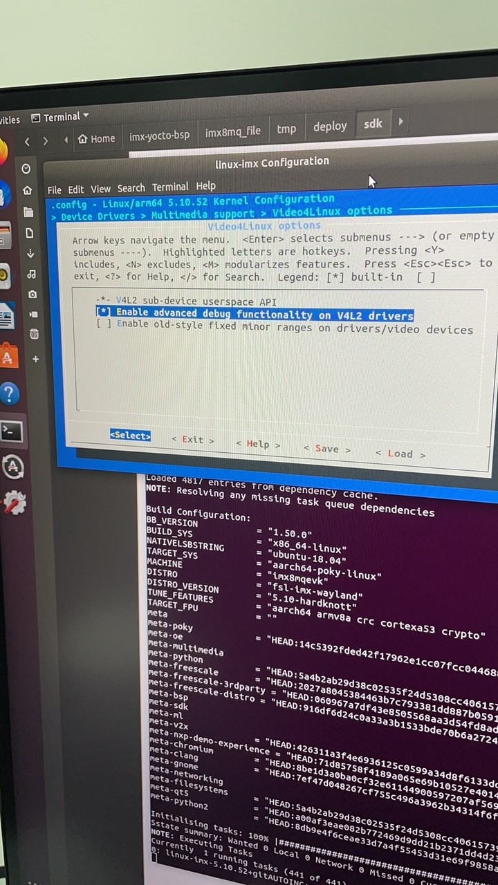

today i downloaded the imx-yocto-bsp based on the yocto guide.
i used the below commands to enable the VIDIOC_VIDEO_ADV_DEBUG then compiled the kernel. however it doesn't work. the kernel generated still is old.
the commands i input is:
1. bitbake -c menuconfig virtual/kernel
2. select the device drivers -multimedia support video4linux options --enable advande debug functionality on v4l2 drivers.
3. save it and rename the config file with v4l2_debug.config
4. exit the menu
5. bitbake -c compile-f linux-imx
6. bitbake linux-imx -c compile_kernelmodules -f -v
7. bitbake -c deploy -f -v linux-imx
no error was found during these operations.
i got the image , rtfs modules in the /tmp/deploy/images/imx8mqevk folder. then copy the image and modules to the sd card.
