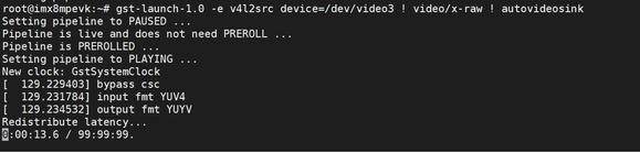

     I encounter failure when I try to use ov5640 camera on imx8mp-evk board and need guide and help.
     I confirm ov5640 camera module (bought together with evk board) works on imx8mm-evk board with command: gst-launch-1.0 v4l2src device=/dev/video0 ! autovideosink with image: LF_v5.15.32-2.0.0_images_IMX8MMEVK.zip.
     I only have one camera: ov5640 on hand, so I connect the camera to imx8mp-evk board J12 (CSI1 MIPI). imx8mp-evk board is downloaded with image: LF_v5.15.32-2.0.0_images_IMX8MPEVK.zip.
     System detected the camera, and v4l2 devices looks ok:

 I try to using different tools to use ov5640 camera, looks nothing error but hang here, so I think there is no problem for start_stream IOCTL, but there is no data return to user space, so user space tool waiting there for data.
$ gst-launch-1.0 -e v4l2src device=/dev/video3 ! video/x-raw ! autovideosink
Setting pipeline to PAUSED ...
Pipeline is live and does not need PREROLL ...
Pipeline is PREROLLED ...
Setting pipeline to PLAYING ...
New clock: GstSystemClock
[ 1802.093915] bypass csc
[ 1802.096289] input fmt YUV4
[ 1802.099019] output fmt YUYV

 When preview with gst-launch-1.0, did not see any capturing on HDMI. when save camera data with mx8_v4l2_cap_drm.out, the size of saved file is always 0. when getting camera data with v4l2-ctl, no data presented (if there is data, could see something like <<<<<<<<<<<<<<<<<<<<<<<<<< from console).

zhangjunsheng
Hi @araja
     You can monitor if there is any interrupt triggered by printing interrupt flags in CSI driver to help you to locate issue.
     user level applcation get data from the stream: Camera (MIPI) - SOC MIPI PHY - SOC MIPI CSI - SOC ISI. Any node in the steam has problem, can lead user space has no data recevied and stuck there.
      You can also check you configuration. I remember OV4560 uses two lanes but I see in your dts configuration is 4 lane, I am not sure if it is the cause.
      You can also read the register with tool /units_test/memtool to read back register and understand the value from SOC user manual during running gst-lunch to know the SOC working status, such as SOC MIPI PHY status.
Best regards.
Johnson
6,988 Views
araja
Hi @Suraj_Vagoli  @zhangjunsheng,
Changing the Data lane from 4 to 2 in dts file made the camera work.
Thank you so much for the support.
