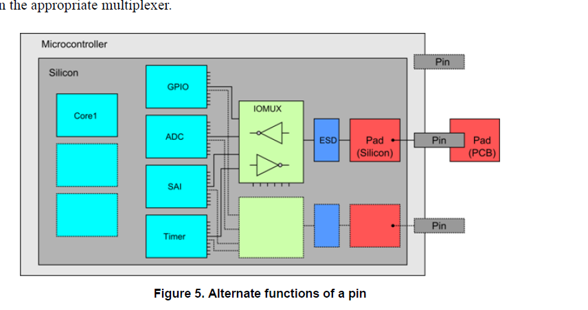

Pin is not gpio.  GPIO is the same as uart, i2c.  without pin configuration. GPIO still can work, just no way output or input, linux uart could work without pin configuration. it is the same.
Please make sure you understand the pin and the gpio, uart, etc. modules.
GPIO is the same as ADC, SAI, Timer.  Pin is related to the IOMUX and IOMUX right side in this picture.
pin pull up/down no any related to the GPIO input/output. pull up/down also can be use as ADC output or input  "pin".
