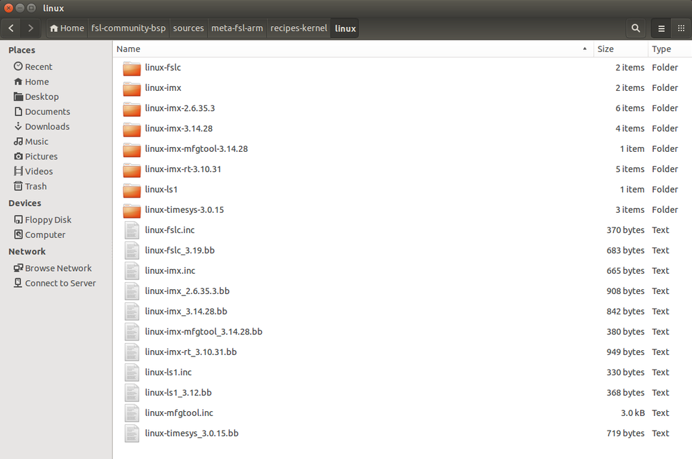

how can i get imx-3.14.28-1.0.0_ga
6,472 Views

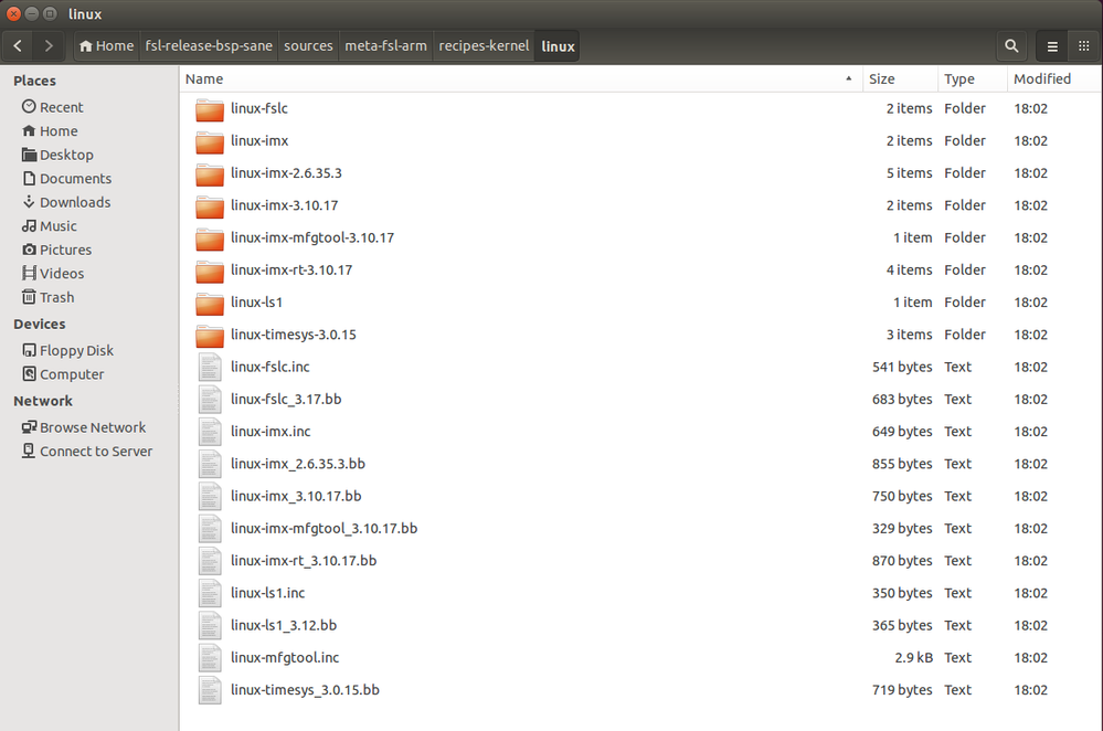

kikimorisato
mkdir fsl-release-bsp-sane
cd fsl-release-bsp-sane
repo init -u git://git.freescale.com/imx/fsl-arm-yocto-bsp.git -b imx-3.14.28-1.0.0_ga
repo sync
but i can not get 3.14.28
how can i get linux-3.14.28 ????
here is fsl-community-bsp
it is linux-3.14.28

Freescale BSP Release options are located in "meta-fsl-bsp-release" directory.

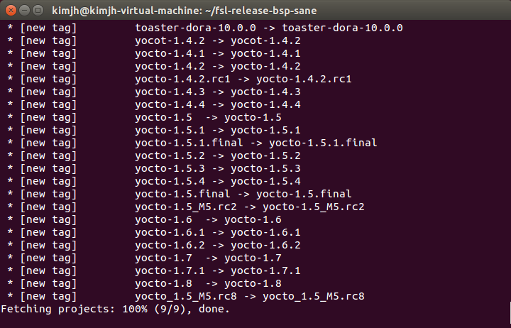

kikimorisato
I did not have any error messages.
I do not use proxies and firewalls.
here is my terminal screenshot
and here is all terminal message
kimjh@kimjh-virtual-machine:~/fsl-release-bsp-sane$ repo init -u git://git.freescale.com/imx/fsl-arm-yocto-bsp.git -b imx-3.14.28-1.0.0_ga

Fetching projects: 100% (9/9), done.
3,162 Views
Yuri
  So, all looks OK. What is the problem ?
Can You continue system building as recommended in "Freescale_Yocto_Project_User's_Guide.pdf" ?
Note, the directory fsl-release-bsp[-sane]/sources really contains only instructions how
to load OS sources and build the images.
Yuri.

kikimorisato
the problem is imx-linux version is 3.0.17 (and all recipes from "imx-3.10.17-1.0.0_ga")
when i used fsl-community-bsp
recipes-kernel version is linux-imx-3.14.28
and bb file included 3.14.28
but fsl-release-bsp(imx-3.14.28-1.0.0_ga branch)'s recipes-kernel version is linux-imx-3.10.17
also bb file included 3.10.17
bitbake -c compile -f linux-imx ==> than linux-imx compiled 3.10.17
i want use imx-3.14.28-1.0.0_ga branch and linux-imx 3.14.28
when i used fsl-community-bsp than everything is OK
but fsl-release-bsp is only 3.10.17
