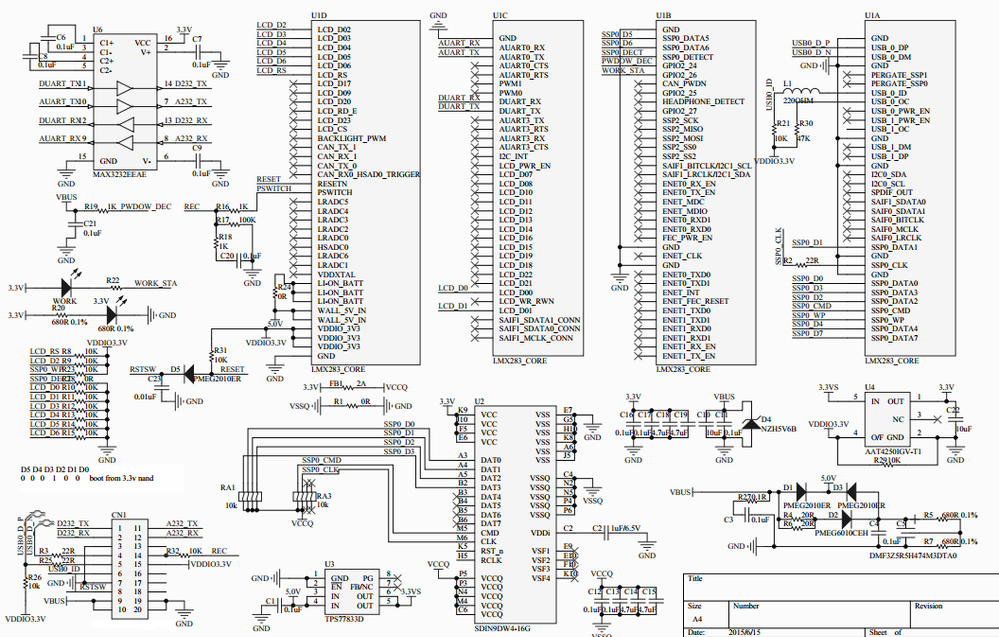

novemer
Isai,
here is part of sch.
IMX283_CORE is a core board base on offical EVM,and it is work well on other projects.i just replace SD card with EMMC.

Hi Wang,
It seems that your schematic is correct.
According to your bootlog you are using battery power, this may cause problems if the regulators are not configured correctly.
In chapter 11 of the Reference Manual:
"If the system is operating from the DC-DC converter and is using more
current than the linear regulators can supply, then the VDDD, VDDA, and VDDIO rails
will droop when 5V is attached and the system may brownout and shut down."
Please make sure that the microcontroller always has valid voltages during eMMC or SD Card R/W operations, which is the time when they use more current. This may be the cause of your shut down.

all bootlog is here,i want to known how to format the chip.
best regards
wang
