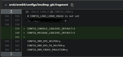

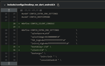

street2409
1. Remove uboot boot delay and output
2. Silence kernel console output
3. Remove unused apps from your build by editing makefiles

street2409
To remove uboot delay, console output, and kernel console output you can google it, it just requires modifying some config settings. My examples:
To remove unused apps reffer to https://community.nxp.com/t5/i-MX-Processors/How-to-remove-Cactus-player-in-the-i-MX8M-mini-Android-...
You can remove any app you don't need, just search the source code for appropriate makefile.

yhm2046
Can you tell me  your example whole path? I can't find it, thanks
