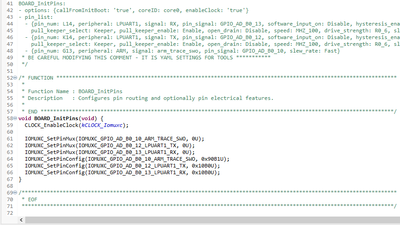

I want to ask that, this is a Uart example, what IOMUXC_GPIO_AD_B0_10_ARM_TRACE_SWO is doing in the hello world example in iMXRT1060.

This is set in case you want to use SWO Trace features on the debugger: How to Enable SWO Trace for i.MX RT10xx Series (nxp.com)
