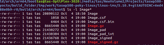

    I have the following files generated
I am trying to authenticate the image with
hab_auth_img <kernel load address> <size image+ivt+csf> <ivt offset>
hab_auth_img 0x4048000 0x1471960 0x418f000

0x1471960 - hex value of Image_signed ( Image + ivt + csf )
0x1470000 - hex value of ivt offset ( Image + pad )
But I am still getting error of invalid IVT structure.
Where am I going wrong?
u-boot=> hab_auth_img 0x40400000 0x1df0f68 0x1df0000
Authenticate image from DDR location 0x40400000...
Secure boot enabled
HAB Configuration: 0xcc, HAB State: 0x99
No HAB Events Found!
