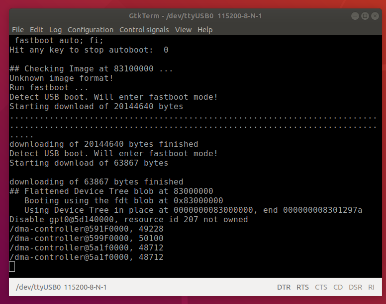

Currently, I am flashing kernel 4.19.35 and my custom device tree in the imx8qxp custom board via fastboot.
UUU command:
CFG: FB: -vid 0x1fc9 -pid 0x012f
FB: ucmd setenv fastboot_buffer ${loadaddr}
FB: download -f Image
FB: ucmd setenv fastboot_buffer ${fdt_addr}
FB: download -f fsl-imx8qxp-mek.dtb
FB: download -f unimog-imx8qxp-sthu.dtb
FB: acmd booti ${loadaddr} - ${fdt_addr}
FB: done
SCFW:
SCFW only uses gpt4 for M4.
ATF:
imx8qx_bl31_setup.c handles the gpt0 . Only change made in ATF firmware was changing from uart0 to uart1, as the custom boards handles.
As the bl31 firmware handles the gpt0 for linux kernel, while booting my device tree and Image, why is gpt0 not owned by A35 kernel?

Hi Hossain
one can look at
i.MX8 Boot process and creating a bootable image
verify that proper scfw version was used : i.MX Software and Development Tools | NXP
https://www.nxp.com/webapp/Download?colCode=L4.19.35_1.1.0_SCFWKIT-1.2.7.1&appType=license
also what is chip revision ? if C0 (suffix "AC") - L4.19.35 should not be used. Try L4.14.98_2.3.0 or L5.4.3
igor

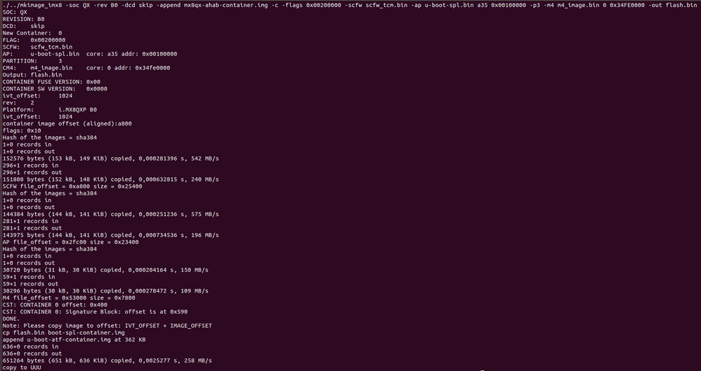

Currently my scfw configured with partitioning. Your reference helped me to build the scfw correctly.
make SOC=iMX8QX flash_linux_m4
SCU console: (provided also in attachment)
Partition 0: --> SCU
Partion 1:-> A35 "In partition 1 gpt_0 is enabled"
GPT_0
GPT_1
GPT_2
GPT_3
But with this flash.bin file, my bootloader is not flashing  I think this due to addressing issue. The reason is flash_linux_m4 does not use:
AP: u-boot-atf.bin core: a35 addr: 0x80000000
Do you think also the same?
Thanks a lot for your informations.
