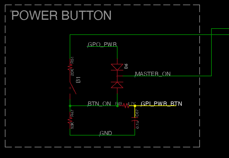

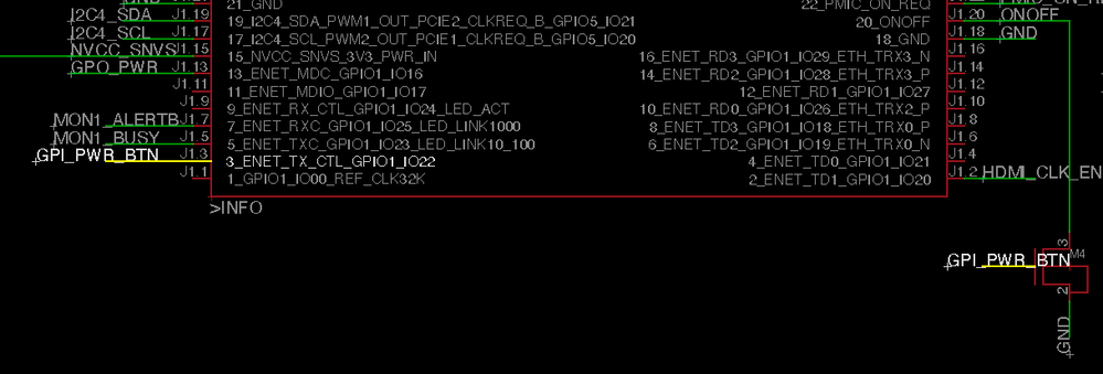

dennis3
Contributor V
Here are the relevant circuits.
This is using the Variscite dart-mx8m carrier board and their version of android is slightly behind the nxp release I believe. 4.14.98 kernel still but 9.0.0_2.0.0 Android release.
Also, our board is battery powered, hence the power button is also driving the MASTER_ON to provide power a battery switch until uboot/linux start driving GPO_PWR to keep the system on.
