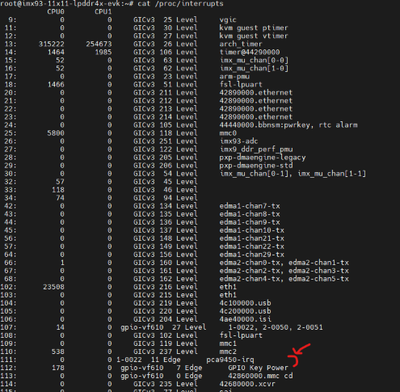

gaurav_sharma
Hi @akbar123 ,
You can configure IRQ on a GPIO and set it as a wakeup source at the same time with something like below:-
This I had configured for imx93evk but you can modify it for your platform.
        gpio-keys {
                compatible = "gpio-keys";
                pinctrl-names = "default";
                pinctrl-0 = <&pinctrl_gpio_keys>;
                power {
                  label = "GPIO Key Power";
                  linux,code = <KEY_POWER>;
                  gpios = <&gpio2 7 GPIO_ACTIVE_LOW>;
                  wakeup-source;
                  debounce-interval = <20>;
                  interrupt-parent = <&gpio2>;
                  interrupts = <7 IRQ_TYPE_LEVEL_LOW>;
&iomuxc {
        pinctrl_gpio_keys: gpio_keys_grp {
                fsl,pins = <
                        MX93_PAD_GPIO_IO07__GPIO2_IO07  0x31e
On your imx linux console, you can verify that interrupts have been mapped via /proc/interrupts
Cheers!!
