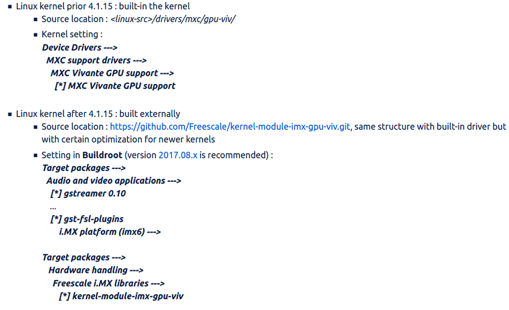

From this link https://boundarydevices.com/customizing-ubuntudebian-kernels/ I learn that galcore module has to be built externally for kernel >= 4.1.15 which is my case. Can anyone confirm?
Khang

This has been my solution :
11,537 Views

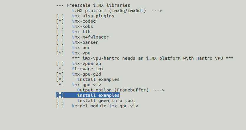

Hello Khang,
Thank you so much for your response.
I actually managed to get it work by not using the driver in the kernel and using the viv kernel module in buildroot. It looks like enabling BR2_PACKAGE_KERNEL_MODULE_IMX_GPU_VIV in buildroot disables CONFIG_MXC_GPU_VIV in the kernel. These are now my configs:

khang_letruong1
Hello Daniel,
If you look at <buildroot>/linux/linux.mk :
$(if $(BR2_PACKAGE_KERNEL_MODULE_IMX_GPU_VIV),
$(call KCONFIG_DISABLE_OPT,CONFIG_MXC_GPU_VIV,$(@D)/.config))
I deduce that just one driver can be built at a time.
