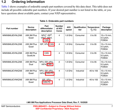

Hi @tamdo
the RM is a general description of the controller, but the enabled features depend on which part-number you pick, details can be found in the datasheet(captured below), FYR~

jim_lin
it's commercial-grade i.MX8MP mounted on the EVK, according to the datasheet, it doesn't have CAN FD support(only CAN)

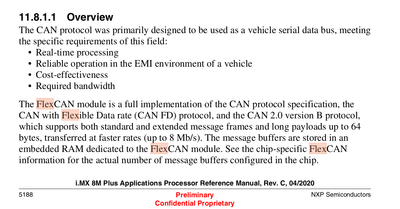

Chapter 11.8 (FlexCAN) of  "iMX_8M_Plus_RM_RevC.pdf" mentioned FlexCAN module has supported  fully to CAN FD protocol.
By the way, could you tell me/us how to active it in our product (I guess that it will need to a pro-support)

jim_lin
Hi @tamdo
