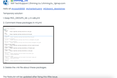

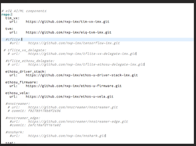

Zhiming_Liu
Hello all @yoooh8668  @charleshuang  @Edward_desplaines
Temporary solution:
1. Keep PKG_GROUPS_ML: y in sdk.yml
2. Comment these packages in ml.yml
3. Delete the .mk file about these packages.
The flexbuild will be updated after fixing this tflite issue.
Update: Gopoint also need to be removed. Any package has Tensorflow dependency should be removed
Zhiming
