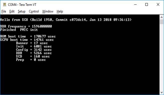

Hi everyone,
i.MX8x use SCU early boot+M4 freeRtos/Autosar to achieve 100MS CAN message answer time from power on when boot with eMMC(not nor flash).we have test the latest released MCU BSP(SDK_2.5.2_MEK-MIMX8QXP), the time from boot up (eMMC boot mode) to can answer time is about 250ms, it can not meet our customer's requirement, so we hope to optimize the bring up time and need your help.
Thanks.
2,578 Views
双朋赵
Hi igorpadykov,
Can you show us the test result, include the time spent when boot with default mode, as well as the fast boot mode ?
we are interested in the following time information
