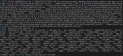

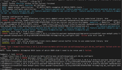

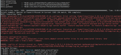

When I built imx-image-full, I found that qtwangland always failed to compile.
raotianxiang_0-1619201930223.pngraotianxiang_1-1619201968515.pngraotianxiang_2-1619202024440.png
Test config.qtwayland_client.tests.dmabuf-server-buffer tries to use undeclared library 'drm'
lib drm ?
I had cleanall-ed them and rebuild , but no effect
How to solve this problem ?
