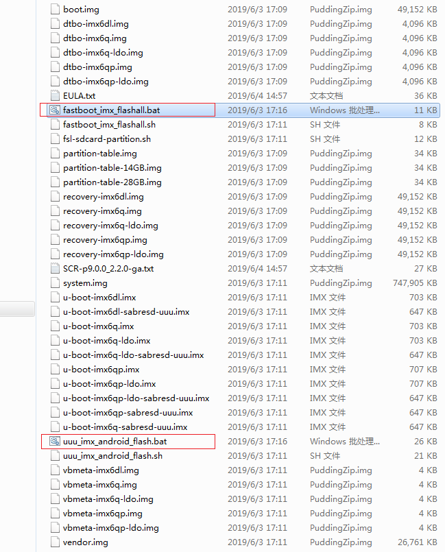

After decompressing it, you will see these files:
files in red rectangle are 2 .bat files, which inlcude all commands for downloading, open one of them by text editor, you can find how to use it.

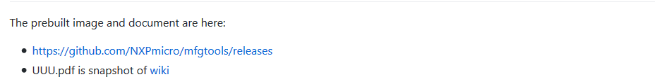

2. the link of uuu tool
GitHub - NXPmicro/mfgtools: Freescale/NXP I.MX Chip image deploy tools.
On the page, you can also find the link for downloading uuu tool
After download uuu tool, you can get a uuu.exe file, copy it to the directory of P9.0.0_2.2.0 demo image.
Then run uuu_imx_android_flash.bat or fastboot_imx_flashall.bat to download images to board on command line.
