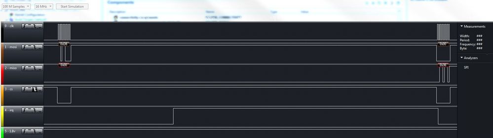

I am doing the debug of ecspi with touch-tsc2008.
I met a issue about I can't receive the data from RXDATA, whie I saw the data from the capture signal according to the following picture.
Can you help me check the configure for why I can't get the data from RXDATA?
the spi configure:
spiTs2008Attach: devFreq=2000000, mode=0, bitWidth=8
imxEcspiTransfer: txLen[1] rxLen[1] mode[0x0]
imxEcspiTransfer: cs=0, transLen=0x2, tx=0x1, rx=0x1, align=1
ctrlFreq=0x3938700, devFreq=0x1e8480, pre=0xe, post=0x1, freq=0x1e8480
imxEcspiChanCfg: confreg=0x70e1f1, configreg=0x100, ctrlFreq=60000000, spiFreq=2000000, curFreq=2000000
imxEcspiChanCfg OK
imxEcspiIsr: statreg=0x3
Tx: 0xd8
Tx: 0x0
imxEcspiIsr: statreg=0x18
omit rx-raw: 0x0
Rx: 0x0
imxEcspiIntTrans: done transfer
Thank you for your support!

I have fixed this issue, which is caused by the IOMUX - "IOMUXC_ECSPI2_MISO_SELECT_INPUT" choose the wrong way.
I use the ecspi2 on the dual-lite, which is different from dual and quad chip.
