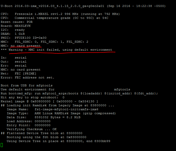

Basically I'm not able to get eMMC recognised in kernel. I am using micron eMMC 8GB and when kernel boots it shows -
mmc1: mmc_rescan_try_freq: trying to init card at 400000 Hz
mmc1: clock 400000Hz busmode 2 powermode 2 cs 1 Vdd 21 width 0 timing 0
mmc1: clock 400000Hz busmode 2 powermode 2 cs 0 Vdd 21 width 0 timing 0
mmc1: clock 400000Hz busmode 1 powermode 2 cs 0 Vdd 21 width 0 timing 0
mmc1: clock 400000Hz busmode 1 powermode 2 cs 1 Vdd 21 width 0 timing 0
####### __mmc_set_clock : max[198000000] min[48339] HZ[20000000]
mmc1: clock 20000000Hz busmode 2 powermode 2 cs 0 Vdd 21 width 0 timing 0
mmc1: new MMC card at address 0001
mmcblk1: mmc1:0001 16ÿÿÿÿ 1.00 GiB
mmc1: Timeout waiting for hardware interrupt.
mmcblk1: error -110 sending stop command, original cmd response 0x2000900, card status 0x2 400900
mmcblk1: error -110 transferring data, sector 0, nr 8, cmd response 0x2000900, card status 0x0
mmcblk1: retrying using single block read
I not getting what is wrong in my kernel configuration.

namratanalawade
Thank you for the reply igor.
Yes, emmc is fully working in uboot. mmc read, mmc write runs without any error.
But, when I try to boot the kernel it shows the I/O error. Below is my dts file configuration
&usdhc2 {
pinctrl-names = "default", "state_100mhz", "state_200mhz";
pinctrl-0 = <&pinctrl_usdhc2>;
pinctrl-1 = <&pinctrl_usdhc2_100mhz>;
pinctrl-2 = <&pinctrl_usdhc2_200mhz>;
bus-width = <4>;
cd-type = "none" ;
wp-type = "none";
keep-power-in-suspend;
enable-sdio-wakeup;
status = "okay";
pinctrl_usdhc2: usdhc2grp {
fsl,pins = <
MX6SL_PAD_SD2_CMD__SD2_CMD 0x17059
MX6SL_PAD_SD2_CLK__SD2_CLK 0x10059
MX6SL_PAD_SD2_DAT0__SD2_DATA0 0x17059
MX6SL_PAD_SD2_DAT1__SD2_DATA1 0x17059
MX6SL_PAD_SD2_DAT2__SD2_DATA2 0x17059
MX6SL_PAD_SD2_DAT3__SD2_DATA3 0x17059
/*MX6SL_PAD_SD2_DAT4__SD2_DATA4 0x17059
MX6SL_PAD_SD2_DAT5__SD2_DATA5 0x17059
MX6SL_PAD_SD2_DAT6__SD2_DATA6 0x17059
MX6SL_PAD_SD2_DAT7__SD2_DATA7 0x17059*/
Please let me know if I'm doing something wrong / missing out anything in above config. I'm using kernel version  4.1.15.
10,606 次查看
fabio_estevam
bus-width should be 8 in your dts.
Also:
cd-type = "none" ;
wp-type = "none";
are not correct.
You should add: non-removable; property to indicate that there is no card detect pin.
