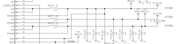

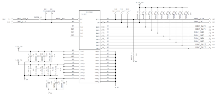

In my design,IMX8M Plus + eMMC(SDINBDG4-8G) is used.
the schematic is refer to NXP development kit.
eMMC’s PS is from PCA9450C.
But, when boot form eMMC,the error is below.
Only one  board (others is ok)has error as shown in the following capture.
Even if SoC and eMMC exchange with new parts, the phenomenon still does not disappear.
Pls help to resolute this. Thanks.

In this case, I recommend checking all the voltages, if all the voltages are good, please check all the resistors of the MMC, and for the last task, please check all the signals with an oscilloscope or logic analyzer.
Please compare each signal with a functional board.

1. I have checked all singals with an oscilloscope, but Data Strobe singal always is low level.
    I think that the other sigals are coincident. It is strange.
2. 4/21 I have checked PS, all are right.
    Just I check PS again, and P1.8D from PCA9450C has became 3.3V.
    PCA9450C is damaged?
best regards.

Check the signal SD_VSEL of the PMIC (pin 29)
If the SD_VSEL is ok, you can reconfigure the PMIC configuring the Register "BUCK5CTRL" Please check the details on page 43 of the datasheet.

As datasheet, Buck5(P1.8V) is not related to  SD_VSEL.
Load Switch output voltage is decided by SD_VSEL.
I think that the PCA9540C may be demaged.

I think that PMIC only needs a reconfiguration.
If you think that PMIC is damaged, please replace it with a new one and contact your sales to obtain a warranty.
