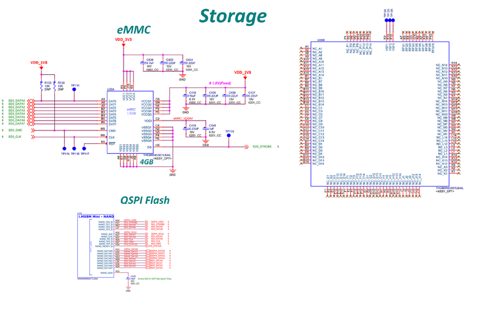

We have a custom board based on IMX8MM EVK DDR4 Board. We have connected an 4GB eMMC to it.
The eMMC fails to initialize in u-boot at CMD8.
error log with eMMC Debug messages enabled:
u-boot=>
u-boot=>
u-boot=>
u-boot=> mmc dev 2

The eMMC schematic and device tree node is attached below:eMMC issue.png

&usdhc3 {
	pinctrl-names = "default", "state_100mhz", "state_200mhz";
	pinctrl-0 = <&pinctrl_usdhc3>;
	pinctrl-1 = <&pinctrl_usdhc3_100mhz>;
	pinctrl-2 = <&pinctrl_usdhc3_200mhz>;
	bus-width = <8>;
	non-removable;
	status = "okay";
Pls suggest  possible solution to the same.
