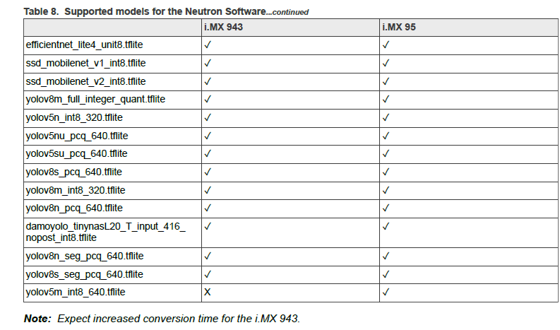

Hi there,
I'm trying to become familiar with the eIQ Toolkit, Neutron converter, and all the available tools for AI/ML from NXP. I'm developing on an i. MX95 board, and it features a powerful NPU core for running models.
Reading the EIQTUG guide, the latest release is 31 Jul 2025. I found (5.8.5 chapter) a list of supported models for the Neutron Software. This lists a lot of models, compatible with the iMX95 chip.
Where can I find these models? How can I integrate and test them? How can I customize them to fit my use cases?
The actual version of the tool I'm using is v1.16.0
Thanks a lot,
Simone

Hello @sicScar1
From internal team:
The models should be available here: NXP/eiq-model-zoo: A collection of machine learning models for vision optimized for NXP products. This repo should have the steps to create/download models that eIQ supports.
Salas.

Hello @sicScar1
I hope you are doing very well.
Please take a look to the i.MX Machine Learning User's Guide in section 9.1 TensorFlow Lite Demos.
There is mentioned a file called download_models.py what is used to download the models.
Actually, you can find the file here.

Hi @Manuel_Salas ,
Thanks for the file link.
As far as I can see, this is partially true. Yes, some models are downloaded, but not all of the ones listed:
Why is that? Am I missing something?
Simone

sicScar1
Hi @Manuel_Salas ,
Thanks for the feedback.
Yes, I knew Model Zoo, but when I looked into it, it wasn't very clear, and the references were old.
Coincidentally, yesterday there was a huge commit with A LOT of changes, just when you wrote me here. So I guess we need to give it a try again and check these modifications done in the model zoo.
For the moment, I'm setting the latest post as a solution.
I will come back if there's something else to check again.
