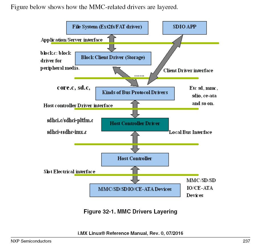

igorpadykov
Hi Ko-hey
Sabre SD linux image uses common linux driver which consists of many layers, refer to below image
it is used in linux high level Bus Protocol Driver : mmc core driver linux/drivers/mmc/core/core.c
note, this driver is developed by linux community.
It is not used in Host Controller Driver sdhci-esdhc-imx.c (which is developed by NXP)
