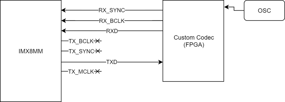

We want to run SAI as Slave of I2S / TDM as follows.
According to fsl-sai.txt\sound\bindings\devicetree\Documentation - linux-imx - i.MX Linux kernel ,
there is an option called “fsl, sai-synchronous-rx”.
Can this option be used when TX_SYNC / TX_BCLK / MCLK is not connected as shown above?
Do I need to connect MCLK?

Hi Kashiwagi
yes
no
igor
