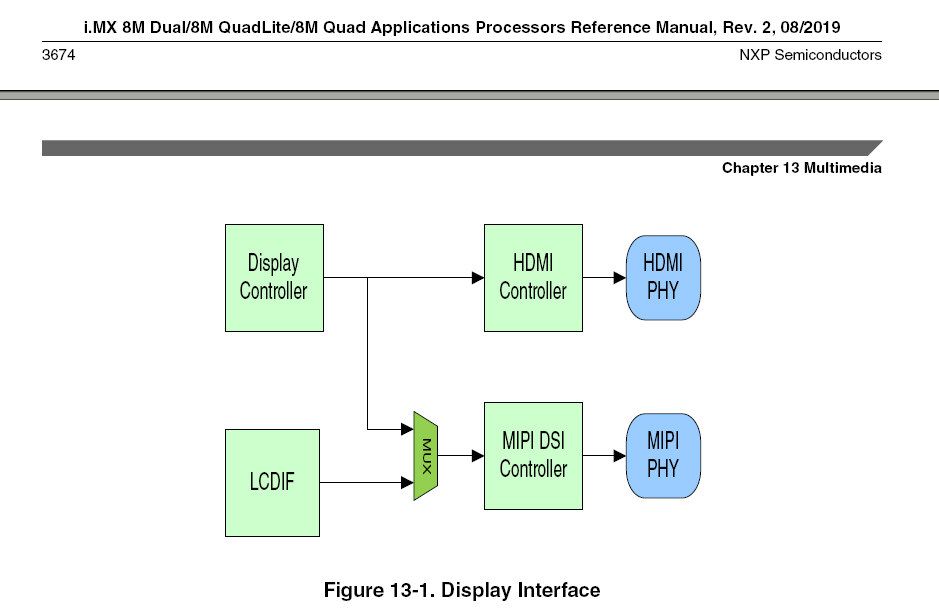

Hi sir
Now I would like bring up the lcdif (mipi-to-hdmi) imx8mq board, the mixel_mipi_phy_probe、adv7511_probe、nwl_dsi_probe、imx_nwl_dsi_probe  run ok, all the devices attach the driver. But when it runs in linux-imx/drivers/gpu/drm/drm_fb_helper.c, it reports the error as blew:
[drm] Cannot find any crtc or sizes
Could you help me check the error?
Attachment is the detailed log, please check。

Hi Hongxing
from log: " picking CRTCs for 1280x720 config
.. drm_fb_helper_single_fb_probe: 1837: desired_mode is null.
...[drm] Cannot find any crtc or sizes"
seems there are problems with configuring panel settings with cea modes,
one can try to debug it in ..gpu/drm/drm_edid.c
Also one can use latest Linux L4.19.35_1.1.0
linux-imx - i.MX Linux kernel
and try solutions provided on Display pixel clock limitation to 74.25 MHz
igor

igorpadykov
Hi Hongxing
in general gpu is not needed, display interfaces are described in
sect.13.1 Multimedia Overview i.MX8MQ Reference Manual
igor
