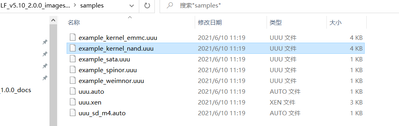

With  a i.MX8MQ evk, I'd like to use a  nand storage as  a  boot device .
At the moment,  uuu   toolkit supports flashing  a bootloader and root filesystem   onto  eMMC and SD Card via USB .
 But, uuu has a known issue  like below .
 "QXP/QM NAND image can’t download by UUU because alignment requirement is difference"
For I.MX8MQ EVK,   can uuu support flashing with a raw nand   like a  eMMC storage ?
How do we fix it?
Can you inform me of above?
Great Thanks.
yes, i.mx8mq supports NAND flash, of course images can be flashed in to NAND via uuu tool
>>i.mx8mq-evk demo image
In our demo image, you can find a samples sub-directory, in it, you can find "example_kernel_nand.uuu" script, which is for nand flash via uuu.
before using it, you should modify image's name to yours.
Have a good day!
