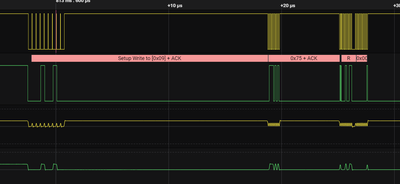

but when controller assigns the dynamic address, SDA is in open drain mode. If the bus doesn't have pull-up resistances, Will the dynamic address assignment process succeed?
Q2:
what mode does contoller send the dynamic address? open-drain?push-pull?
Q3:
What is the time range for effective response from the slave?
the below picture shows the dynamic address is 0x09,
the ACK bit lasts a long time, is it right?

0x09 is dynamic address.
