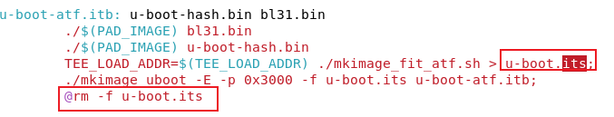

Currently we have our yocto configured to use secure boot, where we sign the bootloader, kernel and device tree.
What I am unable to find are examples using imx-mkimage to create images with multiple device trees / device tree overlays and select them in u-boot.
I've found examples using standard mkimage, which it takes an image tree source (.its) file and how to select a configuration. At this point, I don't know if the same is available in imx-mkimage.
Could you provide an example how to use imx-mkimage to create a boot container with multiple device trees (dtb) and device tree overlays (dtbo)?

Hi  eduardo:
unfortunately we don't have such an example.
Regarding the image tree source image file (.its)  ,   it has already been generated, but it is subsequently deleted.
You can check the Makefile, let's take i.MX93 as an example,
iMX93/soc.mak
You can comment out this line and get the .its file.
