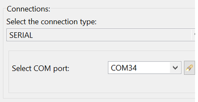

Hello @hermann_ruckerb
The problem is you are not connecting the USB cable from your host PC to USB1 of board.
I have the same log as you when I have not connected that USB cable:
but connecting it, you should be able to run the test without any problems.
My steps:
1. Set the board in Download serial mode
2. Connect the Debug cable to my PC (J1401)
3. Connect the USB1-C of board to my PC too.
4. Run the test in correspondent COM port, 34 in case:
And run the test:
I hope this can help to you.
