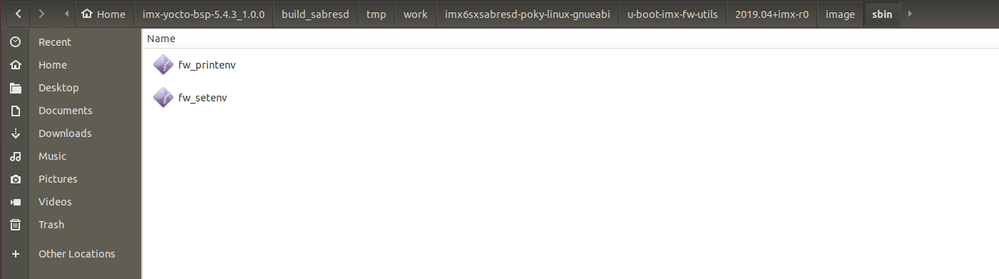

   please follow these steps to add u-boot-fw-utils for i.mx to yocto!
1. copy 2 files in attacments to ~/imx-yocto-bsp-5.4.3_1.0.0/sources/meta-imx/meta-bsp/recipes-bsp/u-boot
2. cd ~/imx-yocto-bsp-5.4.3_1.0.0
3. run below comands
# DISTRO=fsl-imx-fb MACHINE=imx6sxsabresd source imx-setup-release.sh -b build_sabresd
# bitbake u-boot-imx-fw-utils -c compile
# bitbake u-boot-imx-fw-utils -c install
then you will get fw_printenv & fw_setenv
Have a nice day!
