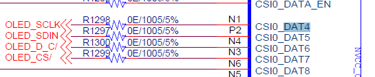

I attached spi device to imx6q.
(spi dev was wired spi1)
pinmap is bellow

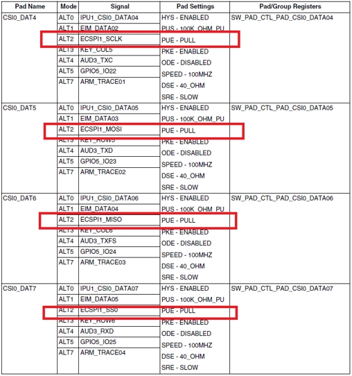

OLED_SCLK -----CSI0_DAT4
OLED_SDIN -----CSI0_DAT5
OLED_D_C/ -----CSI0_DAT6
OLED_CS/ -----CSI0_DAT7
CSI0_DAT4         ALT2     ECSPI1_SCLK
CSI0_DAT5         ALT      ECSPI1_MOSI
CSI0_DAT6         ALT      ECSPI1_MISO
CSI0_DAT7         ALT      ECSPI1_SS0

pinctrl_ecspi1: ecspi1grp {
         fsl,pins = <
            MX6QDL_PAD_CSI0_DAT4__ECSPI1_SCLK   0x100b1
            MX6QDL_PAD_CSI0_DAT5__ECSPI1_MOSI   0x100b1
            MX6QDL_PAD_CSI0_DAT6__ECSPI1_MISO   0x100b1
            MX6QDL_PAD_CSI0_DAT7__ECSPI1_SS0    0x1b0b0
but clock signal does not output.
does my dts wrong?
or do I need to set additional setting?

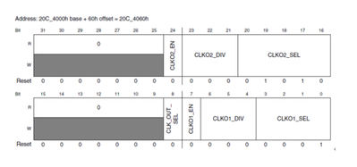

The reason the clock does not tx is because there is no SPI clock setting.
According to the chip manual (IMX6SDLRM Rev. 1, 04/2013),
the PLL should be divided by /8 and /1.
After booting, I set the following additional settings in linux application,
and the clock signal came out normally.
/* 2nd : change clock Register (CCM_CCOSR) */
    /* chip manual : 18.6.21 CCM Clock Output Source Register (CCM_CCOSR) */
    setting=0x0;
#define CLK01_SEL   ( 1<<3 | 0<<2 | 1<<1 | 1<<0) //1011 ahb_clk_root
#define CLK01_DIV   ( 1<<6 | 1<<5 | 1<<4) //111 divide by 8
#define CLK01_EN    ( 0<<7 )
#define CLK_OUT_SEL    ( 1<<8 )
#define CLK02_SEL   ( 0<<20 | 1<<19 | 1<<18 | 1<<17 | 0<<16)  //01110 osc_clk
#define CLK02_DIV   ( 0<<23 | 0<<22 | 0<<21) //111 divide by 8
#define CLK02_EN    ( 0<<24 )
    setting=(setting | CLK01_SEL);
    setting=(setting | CLK01_DIV);
    setting=(setting | CLK01_EN);
    setting=(setting | CLK_OUT_SEL);
    setting=(setting | CLK02_SEL);
    setting=(setting | CLK02_DIV);
    setting=(setting | CLK02_EN);
    read_reg=0;
    mmap_ioctl((unsigned long)&CCM_CCOSR, &read_reg, MMAP_RD);
    if(read_reg != setting)  {
        printf("@%p(CCM_CCOSR) change property 0x%x->0x%x\n"
                , (void *)&CCM_CCOSR, read_reg, setting);
        mmap_ioctl((unsigned long)&CCM_CCOSR, &setting, MMAP_WR);
thank you.

//mux setting
@0x20e0080(IOMUXC_SW_MUX_CTL_PAD_CSI0_DATA07), read_reg 0x5
@0x20e0394(IOMUXC_SW_PAD_CTL_PAD_CSI0_DATA07), read_reg 0x1b0b0
@0x20e0074(IOMUXC_SW_MUX_CTL_PAD_CSI0_DATA04), read_reg 0x2
@0x20e0078(IOMUXC_SW_MUX_CTL_PAD_CSI0_DATA05), read_reg 0x2
@0x20e007c(IOMUXC_SW_MUX_CTL_PAD_CSI0_DATA06), read_reg 0x2
@0x20e0388(IOMUXC_SW_PAD_CTL_PAD_CSI0_DATA04), read_reg 0x100b1
@0x20e038c(IOMUXC_SW_PAD_CTL_PAD_CSI0_DATA05), read_reg 0x100b1
@0x20e0390(IOMUXC_SW_PAD_CTL_PAD_CSI0_DATA06), read_reg 0x100b1
//spi settng
@0x2008008(ECSPI1_CONREG), read_reg 0x7020f1
@0x200800c(ECSPI1_CONFIGREG), read_reg 0x100
//clock setting
@0x20c4060(CCM_CCOSR), read_reg 0xe017b

Yuri
@villager
   I looked at Your mux settings. As I see IOMUXC registers addresses do not correspond i.MX6Q.
They are for i.MX6S/DL.
  What is exact i.MX6  part  number on Your board?
Yuri.
