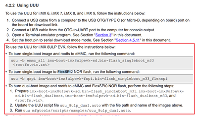

Dear all,
    My steps are as follows:
     1、Generate container image table with imx-mkimage
make SOC=iMX8ULP REV=A1 flash_dualboot
     Result boot image container is iMX8ULP/flash.bin
     2、Write flash.bin to flexspi0 nor flash with uboot
     3、switch to low-power boot mode (sw5[8:1] = 1000 0001)
     4、 open fourth enumerated serial port(Cortex-M33’s serial console)
      But  the console print nothing!
      What's wrong with my steps?
      Thank you so much!
Regards!
493 Views
Zhiming_Liu
Please refer this, if you want to burn dual boot image, need to prepare four files.
The uuu_8ulp_dual.auto can be got from the demo images.
Reference: https://www.nxp.com/docs/en/user-guide/IMX_LINUX_USERS_GUIDE.pdf
Zhiming
