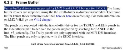

igorpadykov
Hi ekrem_sahin
reason may be that frame buffer drivers are not supported for i.MX 8.
igor
