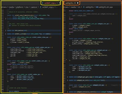

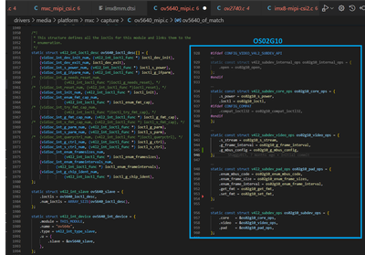

btarnowski
Regarding v4l2-ctl --device /dev/video0 --all  and  gstream no progress.
Looks like it is camera sensor driver issue.
dev/media0 - is not necessary
There is different approaches for handling camera sensor.
Below you can see differences for low level API handling.
ov5640 (camera sensor) works on other device.
And the other comparison:
8,799 Views

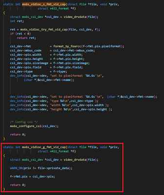

JustADevGuy
hi @btarnowski
for the display thing with v4l2-ctl --all, you just need to edit mx6s_capture.c In function 'mx6s_vidioc_s_fmt_vid_cap' : just copy the whole pix struct instead of just width/height/sizeimage/field
csi_dev->pix = f->fmt.pix;
this way, internal struct csi_dev->pix has all the information needed when you do a get_format (see function mx6s_vidioc_g_fmt_vid_cap)
i feel mx6s_capture.c is full of little mistakes and needs a lot of improvements to have a better compliance with v4l2 tools.
regards
8,610 Views
btarnowski
Looks like mx6s_vidioc_g_fmt_vid_cap is incomplete.
mx6s_vidioc_s_fmt_vid_cap has all details
