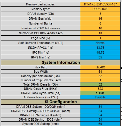

zhuyujun
Hi Judy:
  This is my configuration for your reference:
Best regards!
Yujun

twmemphis
Hi!
I would prefer to have the full file instead of just the basic settings.
As you set the tRCD/tRP/CL to 13.75ns, this - divided by cycle time of 1.894ns and rounded - results in 8 cycles for your CAS Latency and 7 cycles for CWL, which JEDEC calls a DDR3-1066 8-8-8 setting.
Per JEDEC the tRCmin at that speed and CL setting is 52.5ns and the tRAS min is 37.5ns
But I think the DDR Register Excel tool sometimes makes some wrong calculations, thus please send me the full file.
Usually tFAW is also set incorrectly.
And I have some questions, for example if you were running the calibration or not. And how did you find the DRAM DSE settings?

twmemphis
Hi Yujun,
I am working with Junie on the issue and I think we are coming closer to get it solved. Some timings were incorrectly set, but still some fine tuning on the IOMUX SW PAD registers seems required as it still is not stable enough.
I would like to also help you as well to fix the timing registers. I have sent you a private message over this forum.
Thorsten

zhuyujun
Hi, Thorsten:
  I have solved the problem, the max DDR size of i.MX6 is 3840MB:
  It works ok when I set DDR_MB=3840 in uboot.
Best regards!
Yujun
