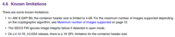

after another reading of that same secure boot with AHAB app note I discovered section 4.section4-6.PNG
The second bullet point answers my question about bypassing authentication by saying if the lifecycle is in an open mode image authentication failure is detected but ignored.  My device is in the "NXP closed" security lifecycle just like the one in that example.  I think that explains why I see 1 SECO event with the "ahab_status" command using the unsigned version of u-boot that I have working.
As it relates to my goal of building a 3 container u-boot that uses SPL to load the Trusty TEE OS, I found the very end of section 3.1.1 of the Android Security Users Guide that shows an example of the "ahab_status" when a u-boot has 3 containers, and it shows that there are 2 SECO events one associated with the authentication failures for each of the unsigned containers (the first container is signed by NXP).
So I'm taking that to mean what I'm trying to do, has been done, but maybe not with Android version 9.0 r3.

I assume the OTP fuses with the SRK hash need to be blown as in order for this to all work.  However, I'm a bit hesitant to blow the fuses if I don't have some reassurance that I can build a u-boot container that works.
I'm using this u-boot with the Android 9.0 release, and I didn't do anything to sign the second container in the non-SPL version (2 containers instead of 3) of u-boot that does work.  I don't see anything in the rest of the Android u-boot makefiles that is signing it, and I don't see the code signing tool in my Android build tree.
I'm guessing that authentication isn't working because I haven't blown the SRK hash fuses and set the security life cycle to OEM closed.  Which would  explain this output I'm seeing to the "ahab_status" call which I can make from my working version of u-boot:
